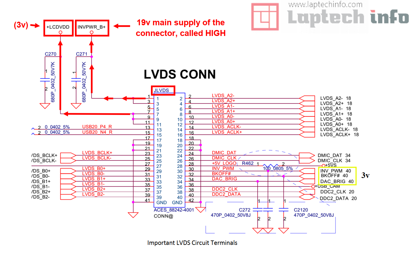

VDS Circuit Analysis:
Photo shows the JLVDS connector (where the flat cable is attached to the motherboard).
It was circulated in red and marked in yellow only the important signals that must be found in this circuit for it to function normally and display an image on the screen.
See that the signals INV_PWM, BKOFF#, DAC_BRIG and + LCDVDD must be 3v for the circuit to work.
The INVPWR_B+ signal is the main supply of the connector, called HIGH, that is, where there must be 19v.
Tip: The voltage of BKOFF#, that is, Back Light OFF must be 3V for the screen backlight to be on, when it is 0V (defect), the screen light will be off.
Note: When making voltage measurements on the LVDS connector, screen and flat cable must be connected.
