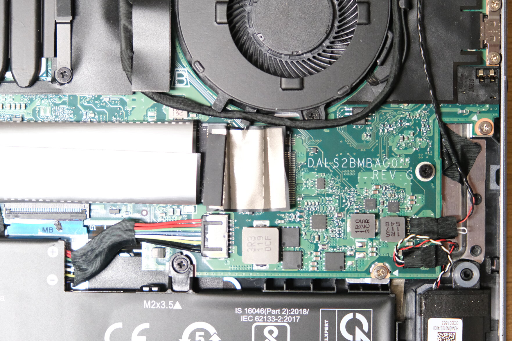

I've checked the booard and believe the Mobo Part is DALS2BMBAG0 Rev G. Any chance there's a schematic for this somewhere to be found? Thank you so much for the help.

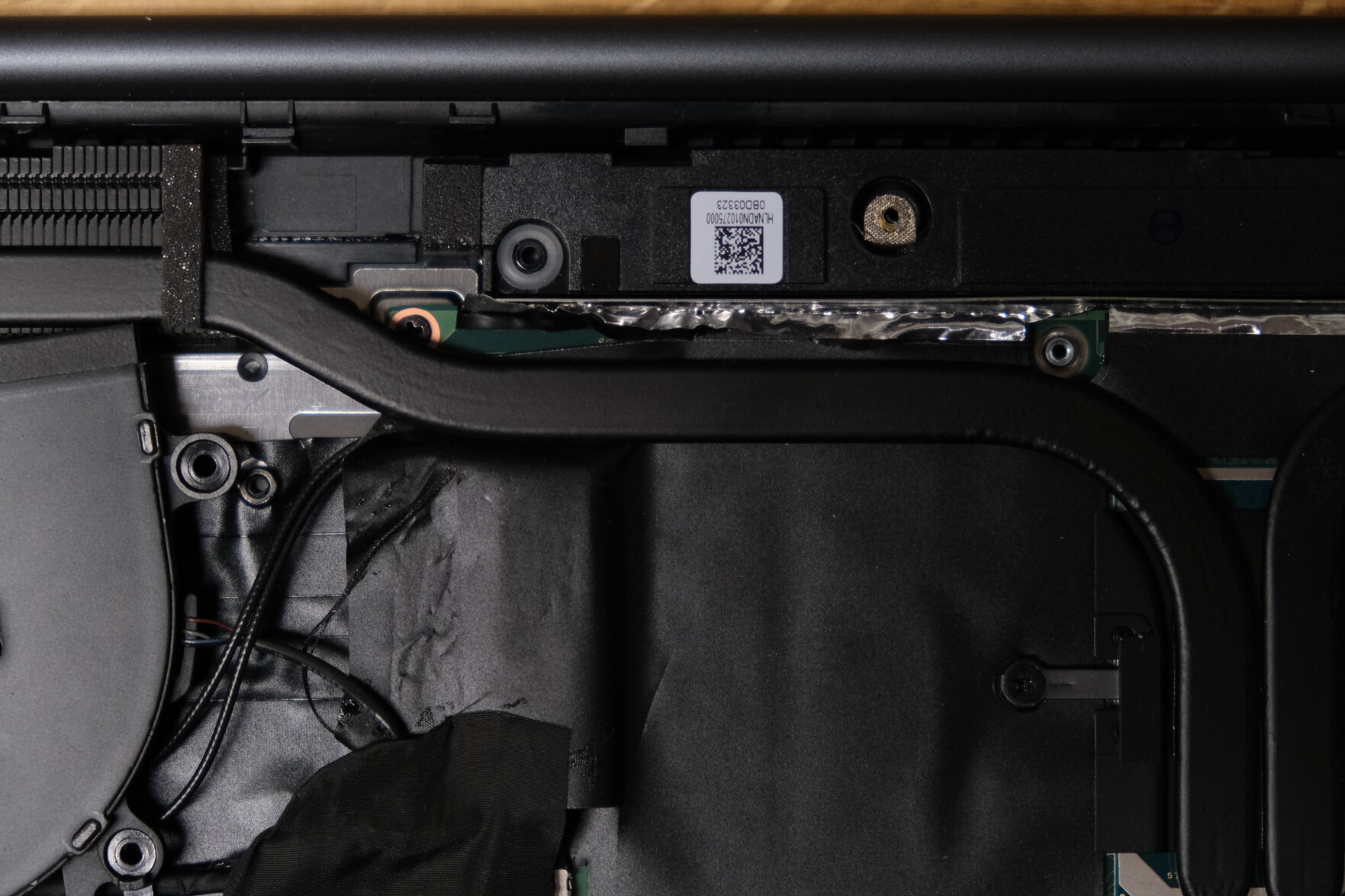

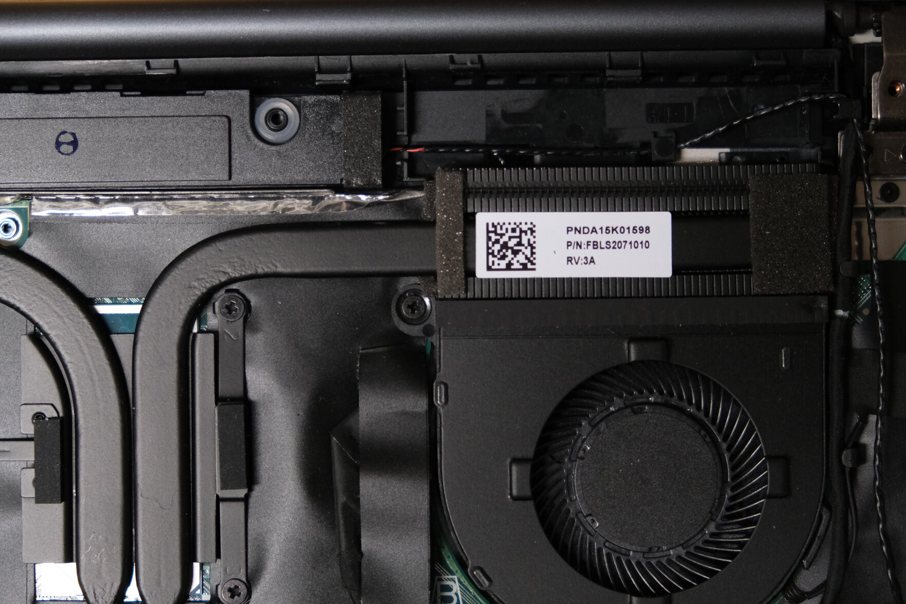

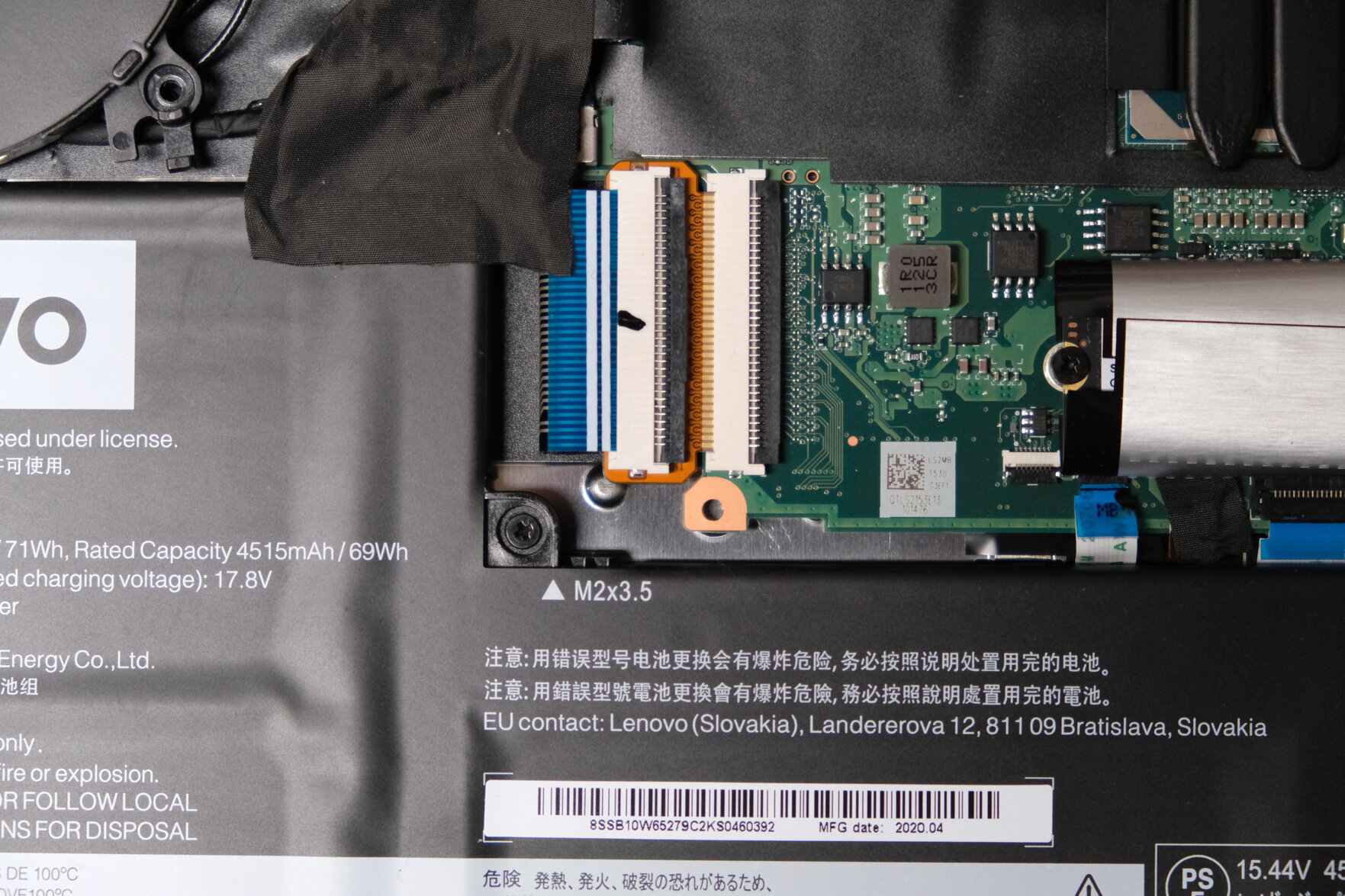

Sure thing, here you go! I've made pictures of pretty much any indicator on the board so that if I've accidently picked the wrong MB part #, it should be included in the pictures.

:-( Thank you so much for looking tho.
Without schematic, it's going to be very difficult to trace the issue.
Yes .. but some assumption we can decide,
Is that exactly 43 seconds ?
Did you try to keep bios screen ...
What is the SIO part number .. let's check that pins with SIO schematics,
